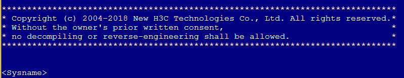

Displaying copyright information
Enabling copyright statement display
This feature enables the device to display the copyright statement in the following situations:
·     When a Telnet or SSH user logs in.
·     When a console, AUX, or modem dial-in user quits user view. This is because the device automatically tries to restart the user session.
Figure 1 shows the copyright statement.
If you disable displaying the copyright statement, the device does not display the copyright statement in any situations.
Figure 1 Copyright statement at the login page
2.     Enable copyright statement display.
copyright-info enable
By default, copyright statement display is enabled.
